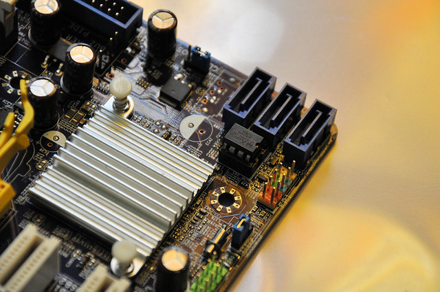

Originally we design this project to read and program BIOS of Foxconn G31MXP mainboard. Our version of G31MXP contains Macronix MX25L8005 8M-Bit serial flash memory and we use this programmer to load some of our custom BIOS to this serial memory.
MX25L8005 SPI flash memory on Foxconn G31MXP mainboard
