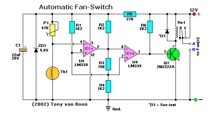

The op-amp used is a readily available LM339. This IC contains four op-amps but we use only two of them. Use the others for spare or do something else with it. For the thermistor I used a small, very expensive ($52), glass-encapsulated type because I had it laying around but almost any type will do. I experimented with a couple different types and all worked
