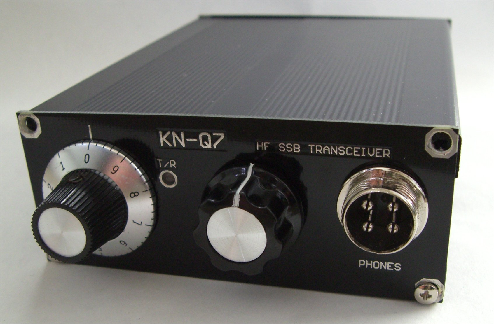

The KN-Q7 is a low power (QRP) transceiver kit designed in China by amateur radio operator BA6BF.

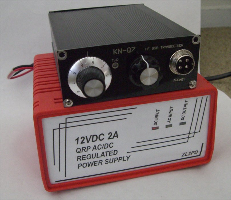

The KN-Q7 40m QRP SSB transceivers shown here with my new AC power supply I've built and described below.

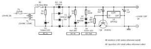

The regulator section of the power supply is a slight variation on the standard regulator design shown in the datasheets for the LM7812 12V 1A regulator. To increase the current capability of the regulator, the datasheet shows a circuit using a high power PNP transistor wrapping around the 7812.
If the circuit is inverted, and a -12V regulator (LM7912) is used instead, you gain two advantages. Firstly, I could use a common cheap NPN power transistor such as the 2N3055 shown here. Secondly, the transistor can be bolted directly to a metal chassis without the need for insulating washers and other costly hardware normally required to keep the collector/case of the high power device isolated from the heatsink.
NOTE!! The connections for the LM7912 are NOT the same as those for the LM7812!!
Other Components
I’ve used a 10,000uF smoothing capacitor in this power supply. The usual design ‘rule of thumb’ is 2,500uF per amp, so 4700uF would be OK. However, more is better, and besides, I had this larger capacitor on my shelf along with all of the other parts. All told, this power supply probably cost me less than $US2! And that was because I didn’t have the LM7912 in my parts bin.
The audio system transformer has a copper band around the outside of the windings, and that effectively prevents the induced hum problem noted with the cheap charger transformer.
The LEDs were in the original charger, and the charger’s PCB, complete with LEDs and front panel which matched the LEDs, was reused. It was arranged in a very similar manner to that shown in the schematic. I chose not to change this, although I think there is some benefit from relocating the red LED to the actual output of the power supply.
As it stands, with my transformer, the green LED acts as a current indicator. Why? Because, on current peaks, the DC input to the regulator falls below the voltage required to keep the combination of the 12V zener diode and 2V green LED fully conducting. It dims nicely at about 2A, and goes out at about 2.5A, giving me effectively a cheap current meter!
I also had to add a higher rated bridge rectifier to suit my new transformer, using diodes also salvaged from older equipment, and I added the slow blow fuse to the original charger PCB in place of the original, unwanted, glass-encapsulated thermal breaker. All quite easy to do.

In service, the power supply worked really well. It’s easily capable of powering the KN-Q7 QRP transceiver. The heatsink/metalwork is probably too small for heavy duty ‘rag-chewing’, i.e. lengthy conversations with the KN-Q7, but it seems fine for my typical two to four minutes of chat followed by a similar period of listening to the other guy. If you plan to talk longer than this, then use a metal box for the power supply and bolt the 2N3055 (or similar) to the chassis.

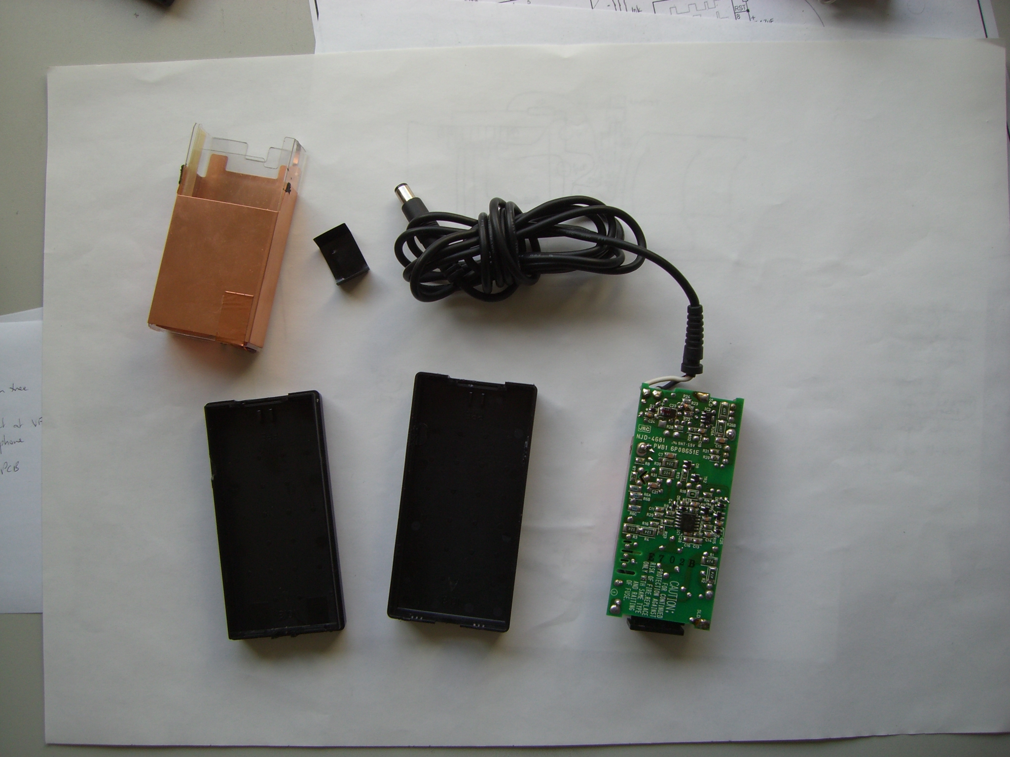

However, they can generate a lot of RF noise. And that proved to be a problem with the one I first tried to use. After adding lots of extra filtering and getting nowhere, I tossed it aside and went to find another one. I visited a recycling center in my town, and bought an old laptop switch mode power supply. It was from a Toshiba computer, and cost me about $US3.
The most difficult task was to carefully break apart the plastic power supply shell. This can be done by carefully easing the two halves of the shell apart using a small screwdriver. Take care not to damage any internal parts during the process.
The copper shielding was temporarily removed. The only modification required was the addition of a tiny 1/8th watt resistor in parallel with one of the voltage setting resistors around the TL431 in the original power supply. The value was chosen after calculating the approximate value I needed based on the TL431 specifications and the values noted in the original power supply. You can see this in the photo below. It's the tiny resistor in the upper center of the picture.
After testing, the copper shield was replaced and the plastic shell glued together again. This modification was very successful, and the result can be seen in the photos.

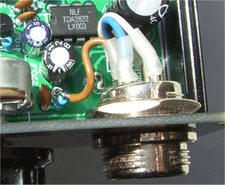

I removed the headphone and microphone stereo phono jacks from the headset. The microphone wiring was connected directly to the microphone pin and ground pin on the front panel microphone connector of the KN-Q7.
To allow me to connect the headphone connections to the speaker output of the KN-Q7, I needed to add a wire to connect the speaker output of the radio to a spare pin on the same front panel connector. Easy! I added a short brown wire from the top of the 10 ohm resistor (R12 on my schematic of the radio, which you can download from here) and that's all that was required. (It can easily be removed if you want to restore your KN-Q7 to original)
The wiring is shown in the photo opposite.
The last step was to add a pushbutton for Push To Talk (PTT) It's the white wire you can see in the photo, and the PTT switch can be seen in the photo above at the end of a short section of grey cable.
