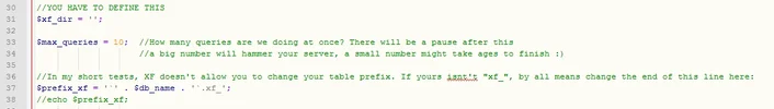

3 - Download the attached "xf2smf.php" file to you computer and edit it with a decent editor (eg: Notepad++). The small edits that are needed are all localized in this part here:
3.1 - You need to define the folder where XF is installed. By folder, I mean the server path where XF's installation is located. SMF's path is automatically discovered (because you will put the file there). If you don't know it, please upload the attached "whats_the_path.php" file to XF's folder and run it via browser. It will tell you the path you should add.
3.2 - You need to adjust my "$max_queries" variable. This defines how many registers the converter tries to move at once. A low number takes a LOT of time, a large number will hammer your server and may cause it to become unresponsive.
3.3 - As my image above states, I didn't find a way to change XF's table prefix, so it shouldn't be necessary to change anything else. But, in case your prefix isn't "xf_" please edit the corresponding line
