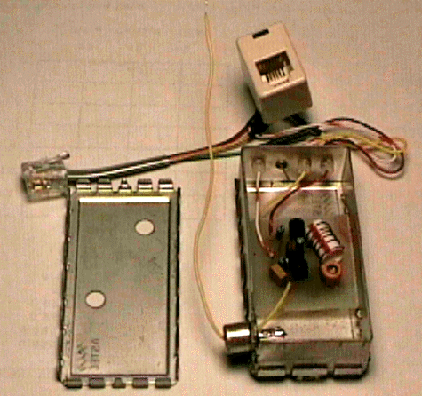

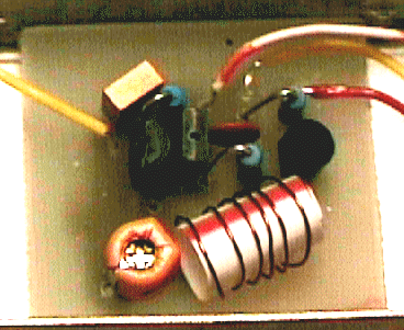

R1 47 ohm resistor R2 680 ohm resistor R3 270K ohm resistor C2 trimmer capacitor (5-40pF) C1 100 pF capacitor C3 47 pF capacitor C4 470 pF capacitor Q1 2N3904 transistor(NPN) Q2 2N3906 transistor(PNP) 1 PC-board 6" black wire 6" red wire 6" green wire 6" grey wire 6" enamel wire for indcutor
Telekulak devresinı yukardaki resimlere bakarak yapabilirsiniz..
