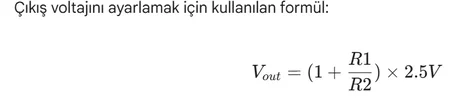

This is simple Adjustable voltage regulator power supply circuit, at use integrated number circuit TL431. By from the circuit can fine volt 3V – 30V, depend on feed volt supply input and change the value R2 , R1. It follow a formula calculates Vout = (1+R1/R2), Vref = 3V-30V , but this circuit gives current get not tall 100mA only. It just if want to enhance current , must use the transistor helps to enlarge current, such as 2N3055, TIP41 numbers or the other.
