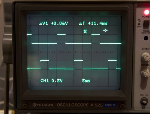

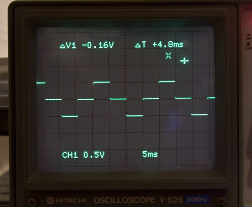

Some information on this circuit. The PIC16F628A is programmed to produce a logic 5v signal for 5ms at pin 17 then 15ms off. Then the same at pin 18, 5ms on then 15ms off (4.17ms for 60Hz). That is one cycle which is then looped. This results in the signals below on the oscilloscope. (2 channel view) You can see the two 5v pulses from pins 17 & 18.
The two separate 5v pulses 180° apart

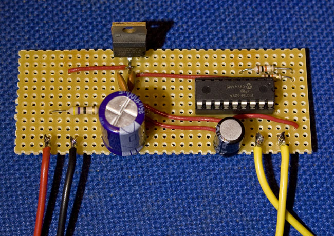

The prototype driver board.

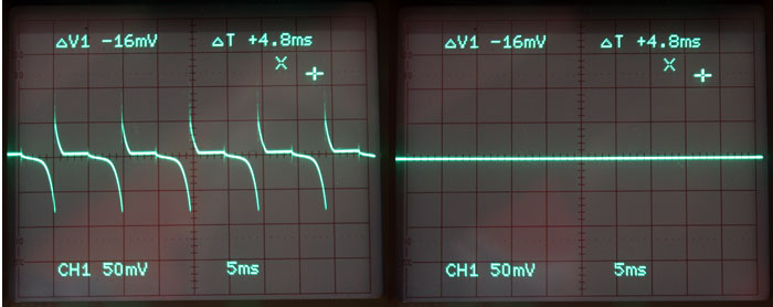

Note the large 1000µF capacitor and 47Ω resistor. These clean up the voltage spikes coming from the transformer centre tap into the positive rail and protect the PIC from them. I learnt the hard way and burnt out 2 PIC’s before looking into the problem with the scope. Don’t think that the 5v regulator will fix the spikes! It and the PIC got hot and then the PIC died. Twice! The image below shows what the power supply looks like at each end of the 47Ωresistor Left is power supply end and right is regulator end. This is with no load on the transformer. The spikes and waveform of them changes with load. The simple resistor and cap cleans it up. This works because the 1000µF capacitor will be seen as a low impedance to a voltage spike. The 47Ω resistor limits the current, so the spikes are dissipated in it as can be seen below.
