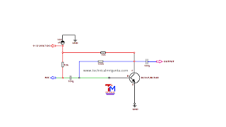

This components are required to make this amplifier.
Spare parts
1. 1×BC547/BC548 Transistor.
2. 1×100uf capacitor.
3. 2×10k resistor.
4. 1×100k resistor.
5. 2×100nF capacitor.
circuit diagram

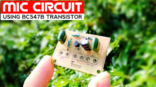

In this post I make a circuit for microphone using BC547B (NPN) transistor. For power supply you can use 9-12 volt DC . Now follow my steps for this amplifier. First we make pcb. For make pcb you need pcb layout. download the pcb layout and print it by laser printer on photo paper. Then cut the pcb layout. Then press the pcb layout by iron on copper clad board. Press the iron 10-15 munites. Then leave the pcb for cool down 10 munites. when the pcb was cool, put the pcb in water and move the pcb layout to copper clad board. Then put the pcb in ferric chloride [FeCl3+H2O] for etching 10-15 munites. when etching was end, clean the pcb by water. Then make hole on pcb. And then press the upper side print of pcb. Now your pcb is ready mount components by instruction.
