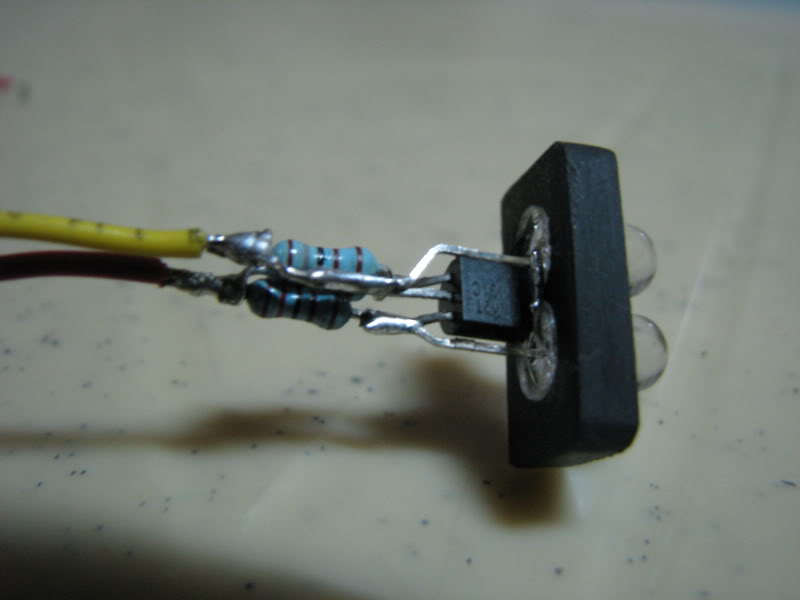

"deadbug" circuit construction makes it easy to install (blue resistors=1% tolerance):
Click the image to open in full size.
LED directly mounted on the circuit, but later opted to wire them as seen on other pictures.

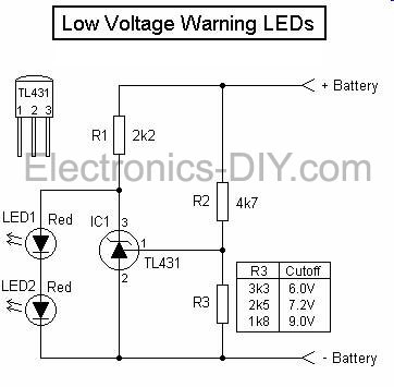

The project consist of a TL431-adjustable shunt regulator, 3 resistors (must be 1% tolerance for accuracy) and 2 super bright LEDs (to ensure visibility during daytime). All these parts are available at Alexan (P50) or any electronics store.
The LEDs will light up when the voltage goes below 9V, since this is a simple circuit, it will light up even on temporary dip in voltage such as when firing the gun, in my testing, the LEDs are not lighting on a fully charged battery even on full auto. When the LEDs starts lighting up during firing, that should be a warning that your batteries are nearing discharge and when they become steadily lit, you should immediately disconnect the batteries and charge them. Lastly, when the gun is not used, disconnect the battery since the circuit will be on (I think the current drain is very minimal but its still good practice to disconnect the battery when the gun is not used).
The circuit above is for an 11.1V lipoly, if you are using a 7.4V, change R3 to 3.3kohms as indicated on the table. If you wish to get indication above 9V, change R3 accordingly, maybe to a slightly lower value.
