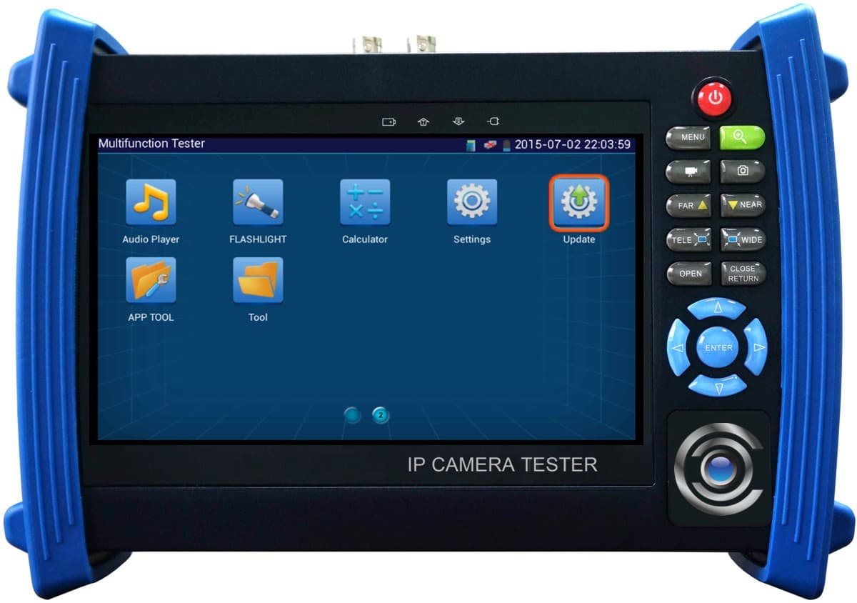

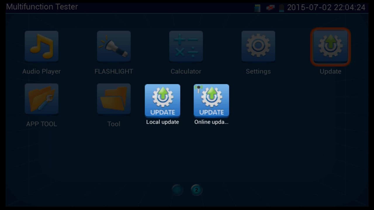

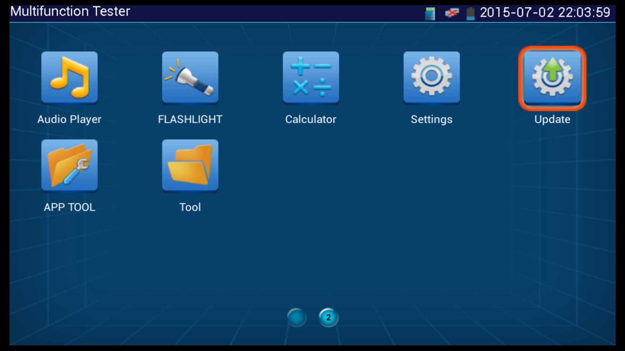

5. On the monitor, press the Update icon. (Shown Below)

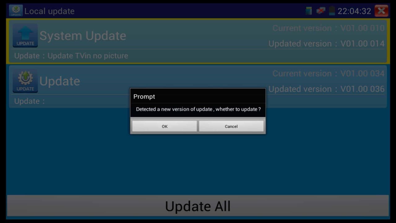

6. Then select the Local Update, you will then be notified that there is a new version of the firmware, click OK to continue. (Shown Below)

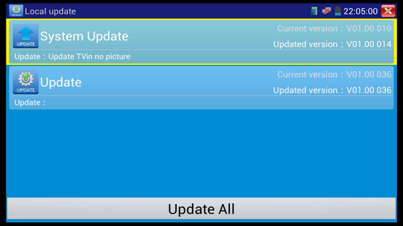

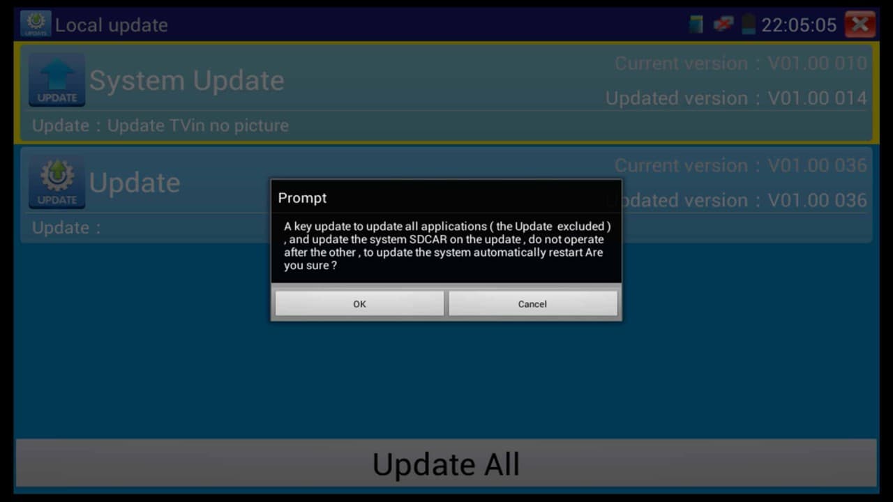

7. On the Local Update menu, press the Update All button to begin the update process. You will then be prompted to restart the test monitor, press OK to continue. (Shown Below)

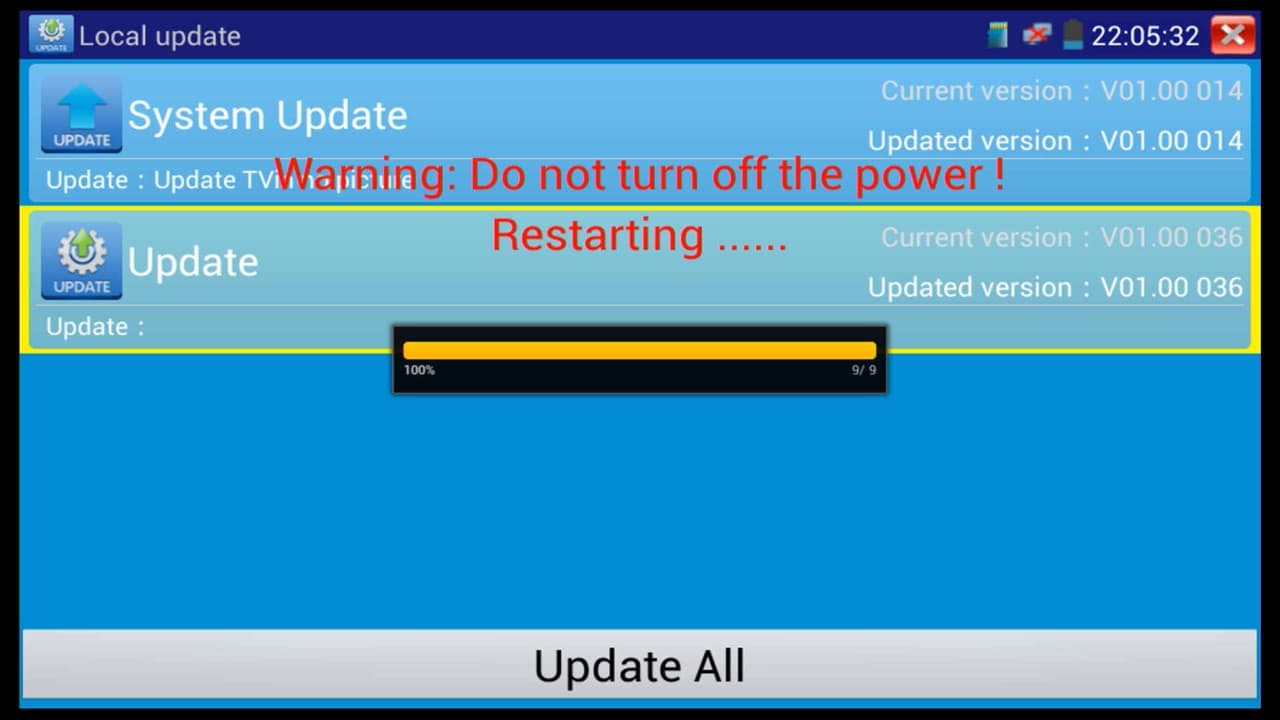

8. The update process will now begin. Once it reaches 100%, the monitor will restart and the update will be complete. (Shown Below)
