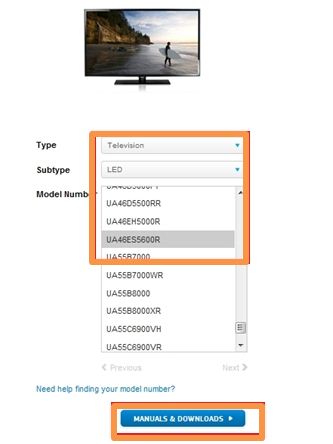

a). On your computer log on to Samsung Download Website and scroll down to select theType / Subtype & Model no. of your Samsung TV and click the button Manuals & Downloads at the bottom.

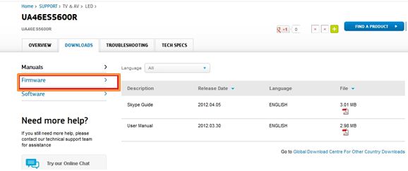

b). Click on Manuals & Downloads, it will take us to the Download page, locate Firmwarefrom the options on the left hand side and click it.

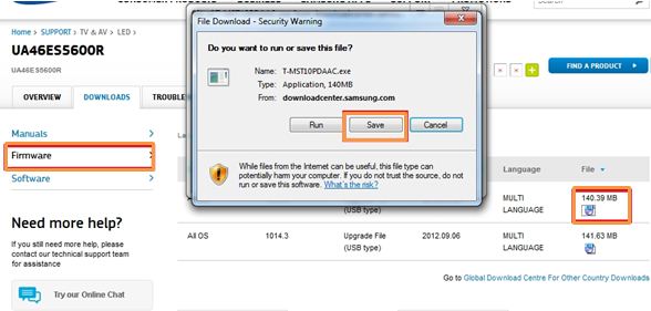

c). On the firmware download page, choose the latest release date and click on the file symbol
, and it will start the download of the upgrade file. Choose the location where you would like to save the file on your computer.
d). Once the files are saved , extract the zip file to a separate folder and then copy the extracted folder to the USB Drive.( Do not copy the compressed file, as the TV might not be able to recognize the format)
