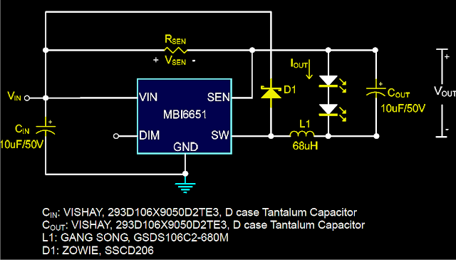

How to Make 1 A Constant Current LED Driver Circuit
The article explains a simple circuit using the IC MBI6651 from MACROBLOCK. The IC has been specifically designed for operating high power LEDs safely by providing a constant current output. The circuit includes very few external components and therefore becomes very easy to assemble at home.

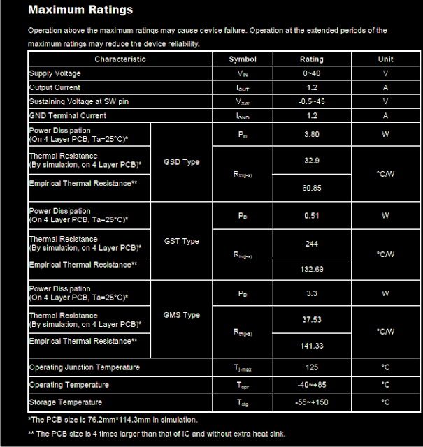

The basic operating parameters are given below:

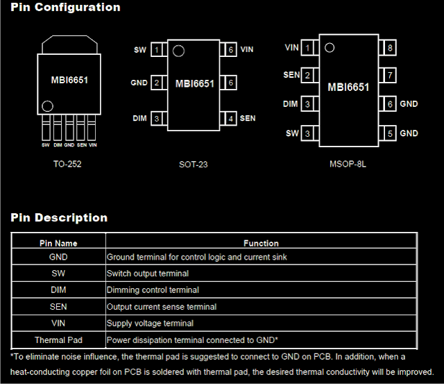

Pin Out Specs:
