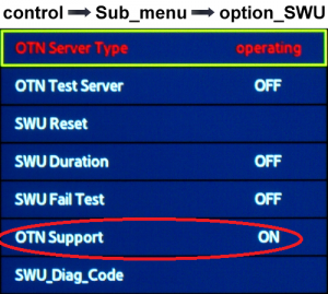

2. Have to turn off the OTN Support2.1 For E-series - have to locate the OTN Support to avoid future firmware updates.
2.1.1 E-5xxx/6xxx : Service Menu -> "Control" -> "Sub Option" -> "OPTION_SWU" -> "OTN Support" -> Off
2.1.2 E-7xxx/8xxx : Service Menu -> "Control" -> "SWU" -> "OTN Support" -> Off
