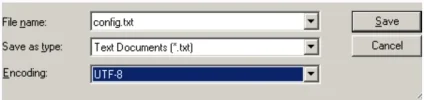

# Save as config.txt with UTF-8 encoding by selecting "UTF-8" from the dropdown menu in the "Save As..." dialog in Notepad. Save it to the same folder as 7zS.sfx and the 7z archive.
The folder should now look something like this:
