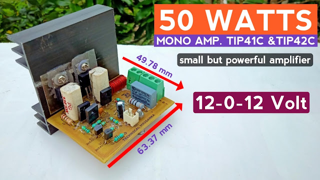

50 watts mono amplifier using TIP41C & TIP42C transistor

Specification
In this post I make a 50 watts mono amplifier using TIP41C & TIP42C transistor. Which can deliver upto 50 watts R.M.S power at 8Ω. It's frequency range 40hz-20khz. For power supply you can use 12-0-12V 5A transformer (don't increase voltage).
