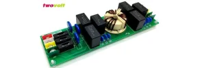

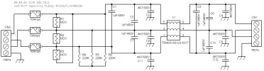

3 PHASE EMC/EMI FILTER CIRCUIT 480V/16AMPS (COMMON MODE CHOKE)
A 3-Phase filter reduces unwanted electromagnetic interference (EMI) noise within the conducted area of electromagnetic susceptibility. This filter is usually used for applications such as frequency converters, motor drives, and machine tools. I have used 100uH Common mode choke, 1uF/480V capacitors and 4.7KPF 1Kv capacitors, fuse provided on all three phase, fuse rating can be selected as per load current. easy inputs and load connections using screw terminal along with earth.
